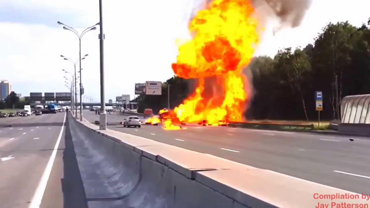

Exhibit 1 M’lud: one moderate sized tank undergoing a single BLEVE. The relevant criteria is not the amount of liquid still to be ignited, it’s (i) the weakening of the metal structure of the tank (ii) over the time the fire outside the tank has been impinging on the tank. Ergo, it is not instantaneous’ Yes it is the second time I’ve used this link, but as it was ignored first time around, I think it is justified

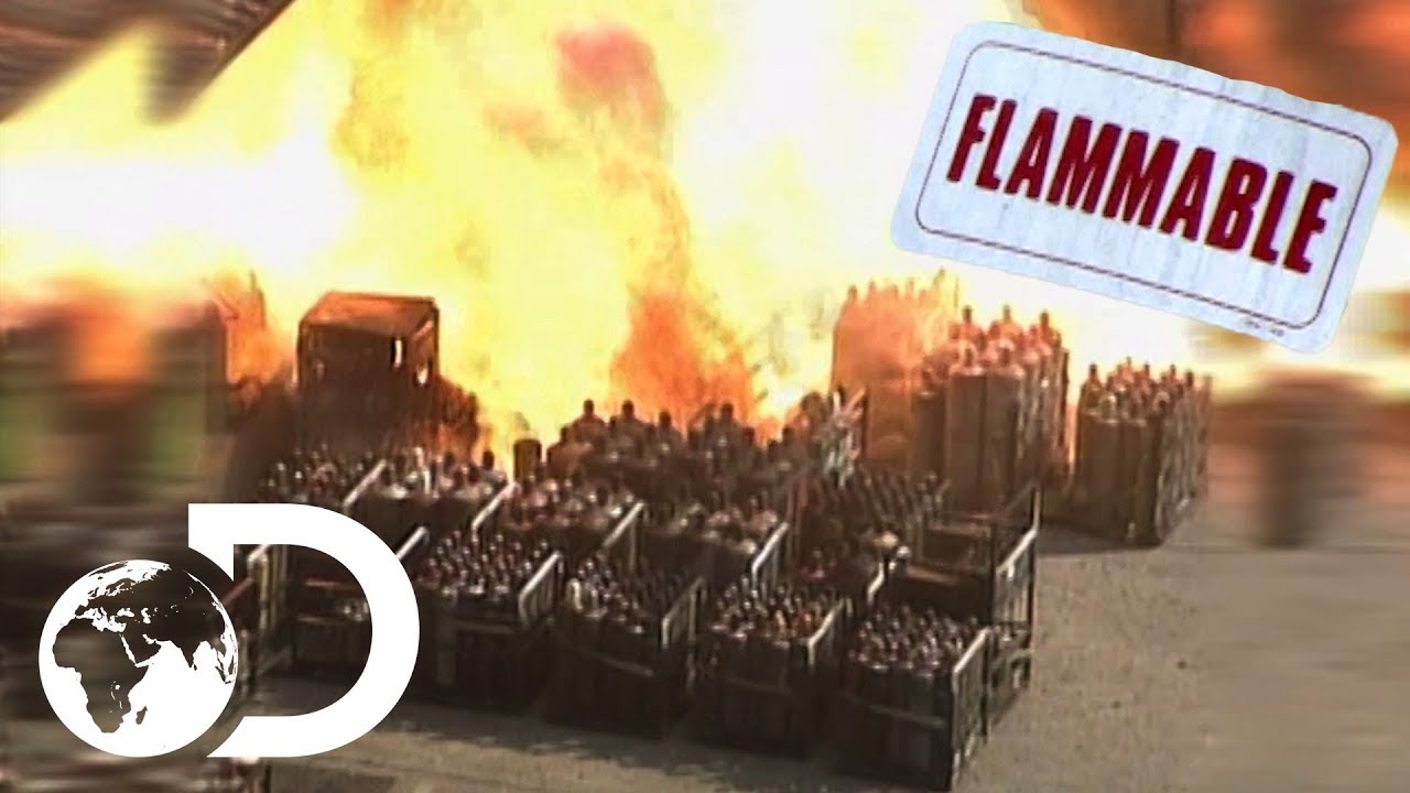

Exhibit 2 M’lud: Multiple mini-BLEVE’s resulting over time as the fire impinges on each individual LPG bottle (propane, butane etc) Again, not instantaneous’.
There’s a version of this I use which has ACDC’s Highway to Hell as the soundtrack, this one doesn’t have the music (due to copyright infringement protection on YouTube)
An event caused by the explosion of LIQUID fuel turning into a fuel and air mix, in a compromised tank, isn’t dependent on the and the amount of LIQUID in the tank and an explosion isn’t instantaneous.That’s what you’re saying ?.
