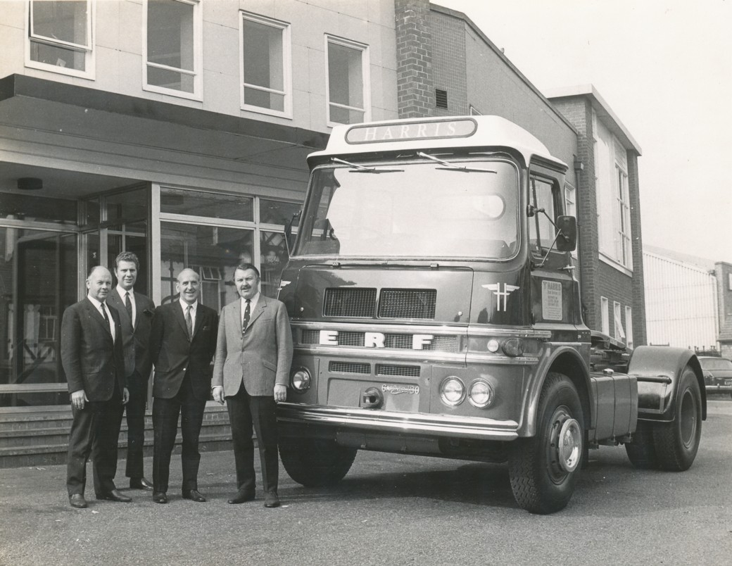

So, there were lots of detail changes, but here we go with a very basic run-down…
LV Boalloy cab - always a ‘set back’ axle, in production 1962-64.
First type LV Jennings cab, always ‘set back’ axle with long doors. In production 1963-65.
2LV Cab - Jennings produced, ‘set forward‘ axle, flush wheelarches and short doors. Only produced 1964-65.
3LV Cab - Jennings produced, ‘set back’ axle, short doors with exposed step, cooling slots in the top grille panel. In production 1965-67.
4LV Cab - Jennings produced, ‘set forward’ axle, short doors, cooling slots in the top grille panel. In production 1965-67.
5 LV Cab - Jennings produced, ‘set back’ axle, short doors, larger cooling slots in the top grille panel (which first appeared on late 3/4 LV cabs). New dashboard and better sound insulation. In production 1967-71.
6LV Cab - Jennings produced, ‘set forward’ axle, short doors, larger cooling slots in the top grille panel (which first appeared on late 3/4 LV cabs). New dashboard and better sound insulation. In production 1967-71.
7LV Cab - Jennings produced, ‘set back’ axle, new larger full grille, 7 inch headlamps, twin heaters, more insulation, engine air filter moved to outside of cab structure. Commonly used on the A’ Series tractor unit chassis. Launched at the 1970 Earls Court show along with the new A’ Series tractor unit chassis. In production 1971-75.
8LV Cab - Jennings produced, ‘set forward’ axle, new larger full grille, 7 inch headlamps, twin heaters, more insulation, engine air filter moved to outside of cab structure. Launched at the 1970 Earls Court show. In production 1971-75.
8
7
6
5
4
3
2
Thanks for that super-clear and enormously helpful synopsis, ERF! Ro
