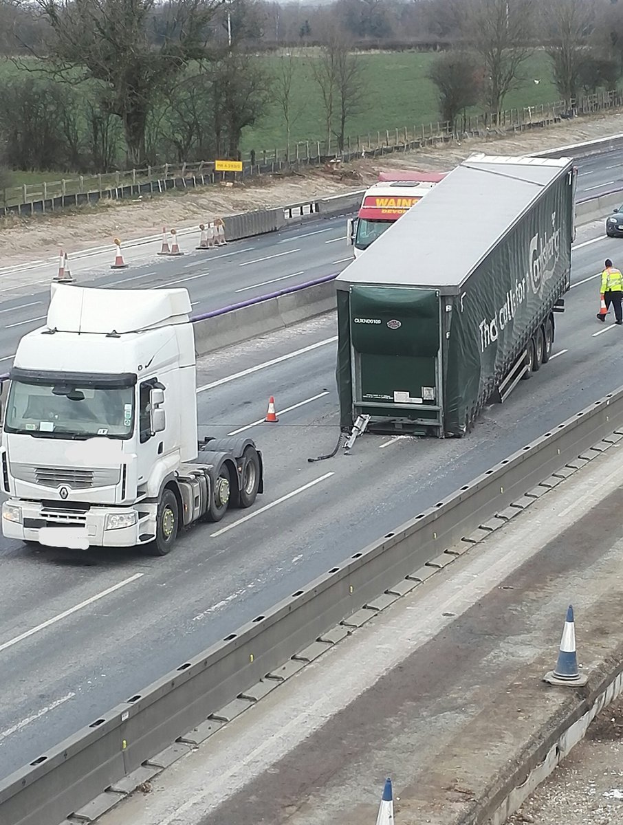

M6 South J19-18 multiple breakdowns and report of possible trailer detachment. Patrols at scene.
![](https://pbs.twimg.com/media/DXRhqgkWAAAR0pk.jpg)
Edit: copied from twitter
COURT RESULT.
Driver convicted at South Cheshire Magistrates Court of Using a Vehicle in a Dangerous Condition. Pleaded Guilty.
Fine & costs £800. Licence endorsed with 3 Penalty points.
Referral to Traffic Commissioner.
i.e. A slapped wrist.
Not a slapped wrist.
A broken nose. And an unfair one at that.

On Twitter It said the 5th wheel was not fully in and the dog clip was not on the driver plead guilty.
I wonder how he made it from wherever he started to it coming off in a straight line on a motorway if that’s the case? Normally they come off on the first corner.
just as well he didnt have to wind the legs up r that would have been another £100 per turn… ![:slight_smile: :slight_smile:](https://emoji.discourse-cdn.com/twitter/slight_smile.png?v=12)
Once the wedge has fired across its going to be pretty much impossible for the two to oart company.
In every case Ive persoanlly seen its driver error, either the wedge hasnt gone fully home or the trailer pin is sat on top of the jaw.
