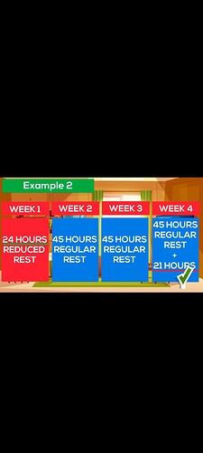

Generally you will legally be able to do one driving shift every other weekend so that you comply with the weekly rest rules

Am I right in saying that if you take a reduced weekly rest it has to be paid back by the forth week. So if only driving one day every other weekend, a day would need to be taken off during week by week 4. So couldn’t work 5 day in one job then work 1 day driving every other weekend.
Only the amount of hours owed by the reduced weekend needs paying back in one go
This would be a typical legal example
Weekend 1
Drive sat 6am to 9pm
Start Mon 8am
That is a reduced weekly rest of 35 hours with 10 to pay back
Weekend 2
Finish Fri 6pm
Start Mon 8am
That a regular weekly rest of 62 hours which is 45+17
10 of that 17 can be used as payback for weekend 1

That make more sense now. Everyday is a school day. Thanks ROG

Just remember that 35hrs 1 minute is fine as weekly rest but 34hrs 59 minutes is not.

Did you mean 45 and not 35 and 44 not 34 :question:
