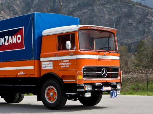

Hallo Anorak, About the Mercs,the first model '64 '65 LP1920 had only the short cab picture 1 and the drivers didn’t like them so MB offered a chassis for building a Pullman cab on it Picture 2. But a lot of customers let extend their cabs.Afterwards MB offered them it’s own long cab version picture 3 and so the Wackenhut fade away.About typs the first two figures is the max weight the other the HP’s
'65 200HP
'67 230HP
'68 240HP
between times 1920 205HP then 1921 with the 1924 engine down rated at 210HP much sold for liquid tank artic’s.
And of course the 1418 sold much at yours,for us was it only a light weight tractive unit
(for example furniture haulage).
Cheers Eric,

Hi Tiptop, the second photo shows the vehicle featured on Biglorryblog. Was there a more luxurious vehicle on the road, in the mid-'60s?
Somewhere else on this forum, one of our Scandinavian contributors marks the standard Mercedes cab down for having a “cold” atmosphere in the cab, due to its having more spartan interior, compared to his preferred Vabis. In the Commercial Motor report on the 1964 Earls Court show, they say much the same thing, even suggesting that the British vehicles in the show were trimmed to a higher standard! The Wackenhut versions were an emphatic answer to this criticism.
The Mercedes website says that the 1920 was launched in 1963 and the ’24 in 1964- their first direct injection lorry engine, some 30 years after Gardner et al made it the norm. Was the 1923 an indirect injection alternative, to satisfy operators who did not trust the “new” technology? Either way, 240bhp was the European standard in 1965 and the British makes had been left behind, in that respect.

Mercedes had the LP,L334 still with the indirect injection OM326 engine in the beginnings of the '60’s. But offered a direct injection from about '62/'63 in the 334 for export.,It was still the same engine with an other head called OM346 which was a bit of disaster in the beginning.But for Germany Mercedes offered still the OM326 indirect injection engine in the L/LP1920. But from '67 on they offered the L/LP 1923 with the all new OM355 direct injection engine who was an everlasting engine and lived furthermore in the 1924. And with turbo in south Amerika and the
Middle East and gave 280HP.
And it was also a bit powerfull with 240 HP and a flyer too and you was good geared with the 12 speed box, and stronger and more torquely as it’s successor the 1926/24 V8 who was completly torqueless, but an everlasting one too.
About other makes with the same output or more (on paper mostly as SAE HP) as the F88 ,with or without turbo couldn’t keep up with it.And about turbo’s even in the fifties most had turbo engines in their avertising brochures but didn’t recommended them to their customers,because they knew it could be a disaster.Of course existed strong natural aspirated reliable engines with high cylinder capacity in V 8,10 or even 12 cylinders but were mostly a calamity on fuel economy. And the complaining about Mercedes that they were cold or spartan cabs maybe yes !! but Mercedes offered a very good ride and roomy cab what did not the F88. Yes the Sweeds had the Bostrom seats,were to handle like a car, the doors didn’t rattle if you closed them and had a very nice power steering in spite of it was a ZF like most other too.And of course nice to drive and a higher sit position as other (so you could look down the others if you overtook them :laughing: :laughing: ),but later in the seventies killed off by the Transcontinental with it’s then unusual high cab.
Cheers Eric,
