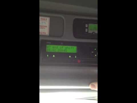

Siemens Digital tachograph 1.3 manual entry (old type digital tachograph)
Not the clearest of videos but it may be helpful.
Siemens VDO Release 1.4 Manual entries (type 1 digital tachograph)
In this video he says that you should use the ? symbol for daily rests, that’s not correct you should use the bed symbol for rest periods, apart from that it should give you a good idea of what to do on this model/type tachograph.
Siemens Digital tachograph 1.4 tutorial.

No you dont need to nor are you expected to, BUT - with the new 1.4 it doesnt give you the ‘end of shift’ after each entry so you need to manually put in all events since the card was last withdrawn.
We’re advised to use ? But I think this is more to do with keeping our entries the same as the older tachos so analysis is easier.
