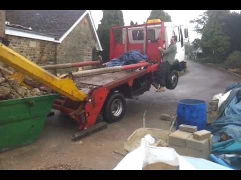

I watched a guy trying to pick up a mini skip and his front wheels just went up in the air. He fetched the builders out and as far as I could tell, the skip was full of concrete slabs, all neatly stacked and with some on their edges to raise the sides a bit.

https://www.youtube.com/watch?v=QUSjIB1MtpE
I just love this guy
https://www.youtube.com/watch?v=5WmFDxrBpjw
And we wonder why we aren’t trusted to keep our keys on loading bays! :laughing:
