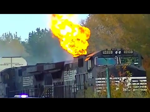

I was once an apprenticeship served truck mechanic back in the late 80’s / early 90’s. In case anyones wondering, I gave it up because the money is crap. Before that, I worked on agricultural stuff for a couple of years after I left school.
Fact of the matter is, any diesel will run off its own oil because of the huge compression pressure as apposed to a petrol (spark ignition) engine. The compression on the diesel is high enough to ignite the oil because the high compression gives a massive temperature rise of the inlet air as the piston squeezes it so igniting the fuel, weather that be engine oil, gear oli or whatever, that’s how a diesel works.
On older tractors, we had to be real careful when when re filling / over filling oil bath air filters for this reason!
The following youtube clip shows an American 4000 HP diesel locomotive running away on its own oil.
Its a 4 stroke V16 of about 12 litre PER CYLINDER and built by Genral Electric.
This particular type of machine does it fairly regular after a turbo failure as it just pumps its own lube oil through the knackered turbo into the inlet manifold. Ive a good friend in the US who’s a locomotive mechanic who gave me the details.
Here’s that big bastrd engine running away-
