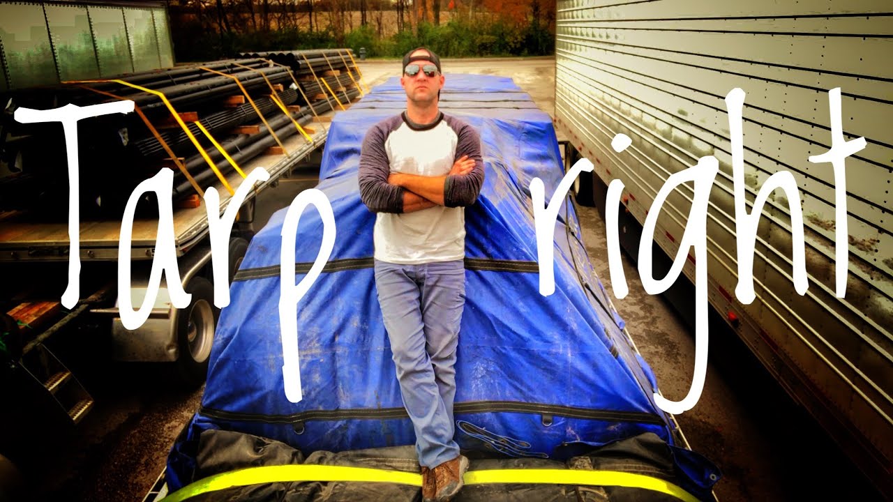

Bungee straps on tarps? Obviously they dont have tropical storms over there, if they did, that tarp job would only be marginally better than holding a beach brolly over the load.
Ha ha, I left an appropriate comment but only went into detail when warning him of severe back problems long before retirement, lifting a rolled sheet like that. :astonished: :rofl:
Some Yanks do have standards apparently, this photo was published with the caption:
I bet this looks great going down the road. It’s a friendly tarp job, it waves at everyone.
IMG_6924
Good comment! :grinning:
It’ll not need a fly sheet. Just shake off the water as it drives along.
Air brake? MPG reducer? Mirror blocker?
