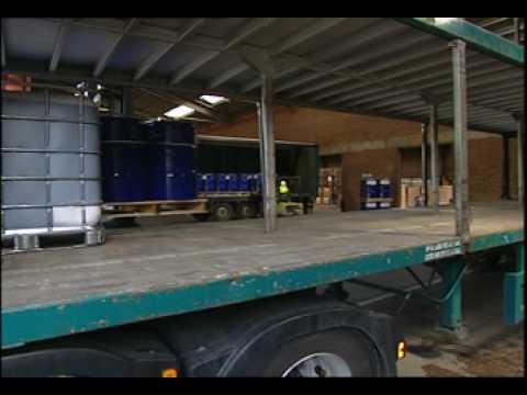

… Although I only have 25yrs of HGV 1 driving, I understand a jack knife to be the result of the units drive wheels losing grip & being pushed sideways by the inertia of the trailer??- with this in mind I never use the engine/exhaust/jake brake on a bend or slippery surface (also bear in mind that a lot of eng/ext/jake brakes are auto linked (unless switched off) to the footbrake)
This is quite a good vid explaining load/vehicle dynamics :slight_smile:

i agree 100% you’ve got to remember that when you apply the exhaust brake it only slows the unit down and not the trailer the trailer is still trying to go at the same speed and in turn tries to push the unit out of the way ?
