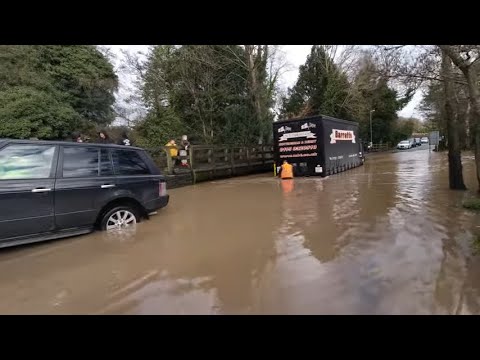

Anyone had any fun experiences driving through floods or similar ?
This guy should of realised … you’d of thought… lol

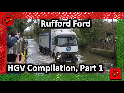

https://youtu.be/kSa9OOuEYis
https://youtu.be/x3aO2AiySSU?t=163
Thats a famous deep water ford in Notts.
Rufford iirc
