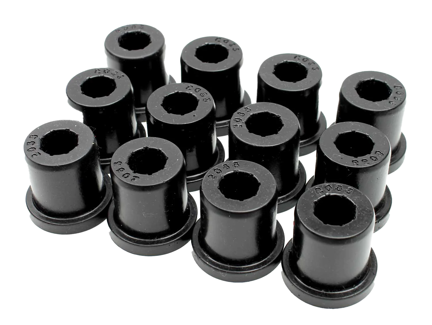

Need bushes for rear spring eyes on mid 80’s Constructor 6 light albion suspension, has anyone got any contacts as to who can supply. I’m in NZ, Thanks Geoff
Bushes - Owen Springs
Owens made me some new front springs for my foden I also bought brass spring eye bushes from them for ERF E series and 1970 Dennis ,worth a try .
The photo is from ■■■ website they do springs too .
