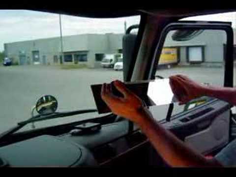

This is an interesting idea, could make your own!

^Ok that mirror idea is pretty cool
