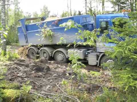

Then, as yanks clearly like their double drives what if they could lift rearmost axle up when running empty and still have genuine double drive without any Robson drives I mentioned previously?
8x4 tipper with rearmost drive axle lifted up and it’s drive disengaged. Note the similar hubs in rear wheels indicating it has double drive. You still get diff- and crosslocks for this “double drive with lift axle” making it by every mean as powerful as ordinary 6x4 but giving you more traction when empty and better turning circle.
If you aren’t believing that vehicle has double drive, then have a look to these two videos:
Interesting part begins from 0:16. Also note similar snow plough equipments as mentioned before.
Interesting part is from 2:19 to 2:30.
From first video you can see what kind of look a hub on a free rolling axle on this make (Sisu) has and hub on the picture of the 8x4 lorry clearly isn’t such. From second video you clearly can see that it really is double drive as rear axles turn at same pace despite another being on air. First video also show the Robson drive in action.
http://www.youtube.com/watch?v=vttgduhZYUQ
http://www.youtube.com/watch?v=PqSxW1C-eS8
