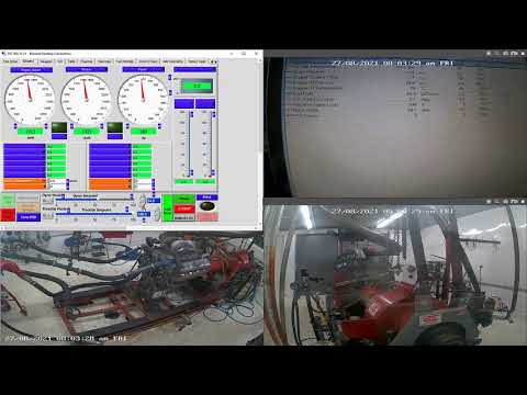

Just the ticket
Tell us what that is ?.Then tell us what the N suffix denotes on two stroke Detroits ?.
To add it’s actually a belt driven blower not a belt or gear driven supercharger.
A Detroit two stroke ain’t supercharged it’s either naturally aspirated ( N ) or it’s turbocharged ( T ) there is no ( S ).
Obviously it’s you that needs the lesson in the difference between a blower v a supercharger.
It’s not a supercharger.it’s just a blower to aid scavenging/induction on start up.Non turbo models are designated N for ‘naturally aspirated’ all have the blower.It won’t start without the blower.
