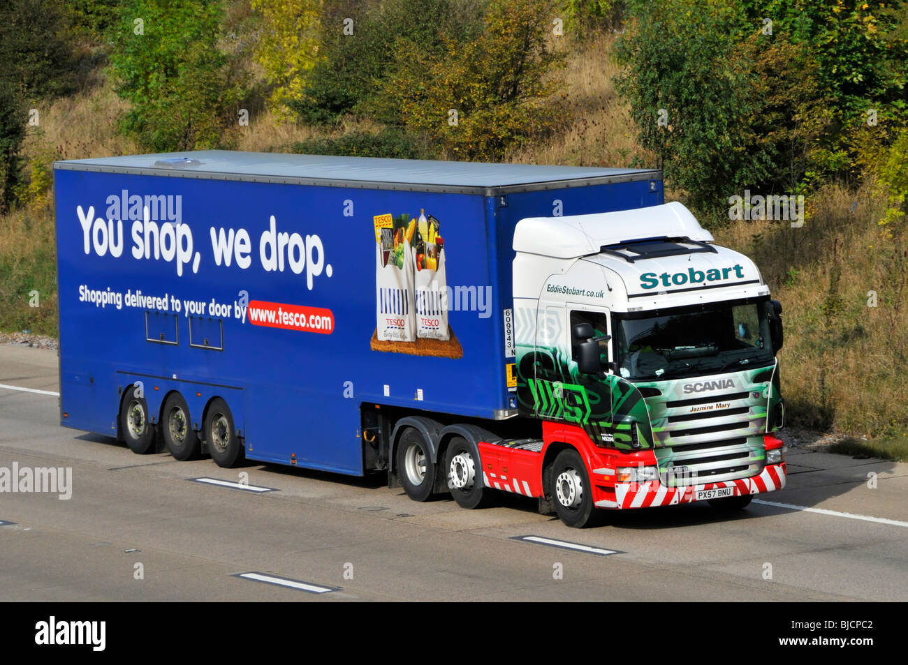

Properly loaded stepframe decker will be as stable or more stable than a regular trailer loaded floor to ceiling.
These styles of DD are even more stable, the top deck is actually only a couple of foot higher than a regular deck.
Own Account Driver:
A ‘step’ in the right direction but…could be lower (with more stability) with a low profile fifth wheel without a chassis plate and smaller twin wheels rather than SS’s.
Still look pretty hideous things though…

Guessing you’ve never pulled one as they lower right down so the whole bottom of the trailer is on the floor with no air in the suspension the wheel size doesn’t make any difference it doesn’t have solid axles it’s essentially a similar design to a car transporter. The centre of gravity is very low.

When there was a road closure and I had to u-turn with one the tail-swing grounded out on the tiniest grass verge you’ve ever seen. I had to get out and faff about raising the suspension to free it in the midst of traffic gridlock. Pulled them for City Link, they spent a fortune on those trailers then decided they wanted to move back to forklifting stillages out of curtainside DDs and ditched them all. The curtainside DDs were several MPG worse on fuel too due to extra height and drag from the curtains.
Can imagine it could in certain circumstances re a real mare to screw round. Re the fuel consumption, with brick wall esq aerodynamics its only going one way…^^^^

A chassis plate fits between the chassis rails and the fifth wheel is bolted to it. Plates come
in various heights.
My FH is fitted with a low profile forged aluminium fifth wheel made by SAF in conjunction with Alcoa which requires no additional chassis plate. It does require open rear arches as the bottom of the trailer is only a few cm above the tyres but…makes for better aerodynamics as a 4M tilt now sits well below cab height…
Brilliant thanks - sounds like a serious piece of kit!
