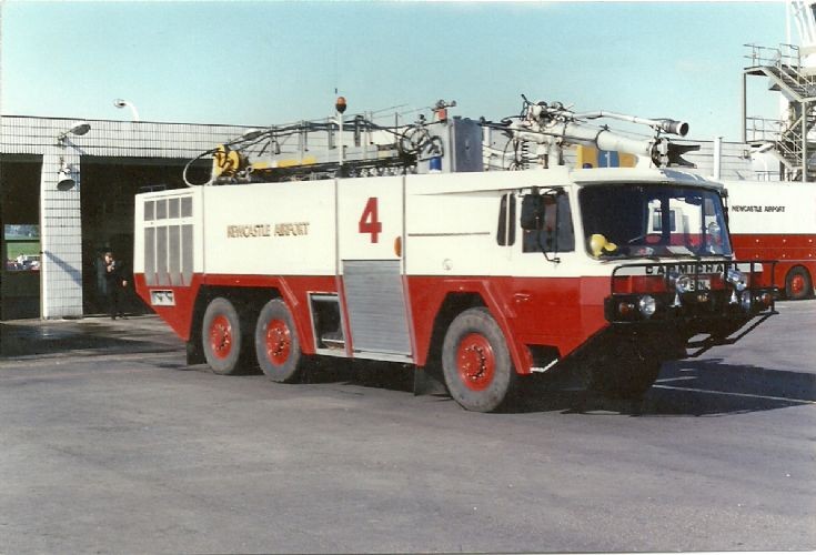

From memory,like the Carmichael example shown here,
fire-engine-photos.com.s3.amazon … /27842.jpg
that chassis type was originally fitted with a VT 903 in it as supplied by Scammell in the form of the Thornycroft Nubian Major 2 which I,for one,didn’t like for its zb power delivery characteristics,although to be fair it didn’t blow up.
But which had obviously then later been based on the firm’s own chassis assembly model after I’d gone and somehow predictably,found itself specced with,the well proven and liked in other types,8v92 in it instead.Just like the Oshkosh HET.
Obviously no point in me trying to explain the finer points as to why getting rid of the induction stroke in favour of another power stroke is a game changer regarding the stroke measurement part of the equation and why the customers didn’t choose the 903 in those applications.
