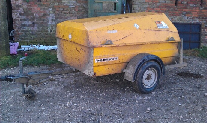

at work (agriculture) we have a similar thing to the yellow bowser, but it’s a metal shell with a plastic tank inside and fitted with a pump, iirc it’s 1100L. what would be the deal with that as regarding carrying red diesel?
cheers, steve

Sorry mate, but I need to ask you the same questions please…
1.) What permanent markings/ info plate you can see on this “tank” please?
2.) You may see the letters “UN” in a circle, then some code… probably starts with the figures 31?
… and if it got a plastic inner, there’ll also be an “H” in the code.
Once I know this, I’ll probably be able to give you an accurate answer. :smiley:
hi dd,
this is the only label / markings i can find.
cheers steve
